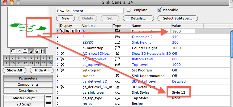

Hi grasping at straws here but I don't suppose anyone out there has fixed the glitch in the Sink General 14 library object? The glitch appears when you select the Sink Style 13 (funnily enough )

Cannot reproduce, see attached.
I will upload my library part for you next post.
EDIT: change the length and yes, what you show happens.
I will open and edit part and upload when correct.

....................... there is a bug in the macro CALL "fa_sinktyp" Parameters ALL
It will take a while to find.

.................. style 11 & 12 is also affected

Fixed as last. If you want to do this yourself the open a macro named fa_sinktyp
You will find in the Folder named Furniture Macros 14
See attached pic where the value given as a should read as 1.5
This is the same for type 11, 12 & 13
............ OR d'load the macro which I will post next.

Wow Rod I go home for tea and go to bed come back to work and you've sorted it all out!
Brilliant thanks!

I just checked it, and fortunately, in ArchiCAD 15 it is already fixed.
