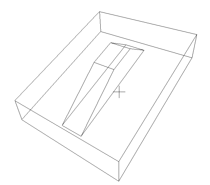

Just for fun I tried that, changing an objects subtype to skylight to see what happened. It did not crash AC (14). However it did not cut hole in roof.
Object was made with Objective, material glass, and had to use seo to cut hole.

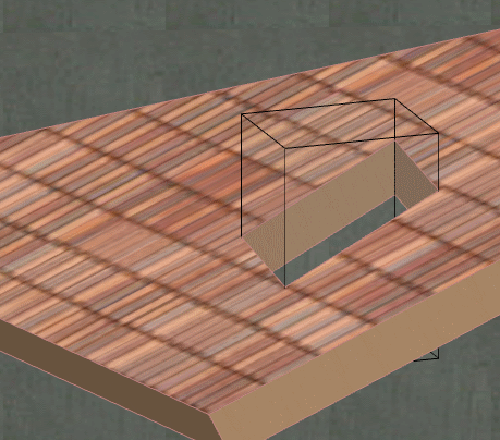

Hello,
I think just making an object with "Skylight"-subtype should be enough to make a hole, even if no code added at all.
If you want to control the edge angles then new parameters should be added as mentioned in the "Fix named optional parameters"-documentation found here
(For other versions than 13 just change the version number in the link).
3. Parameters for add-ons
Add-ons can get values from library parts through parameters with predefined name and function. The list of such parameters in connection of the AC-package add-ons follow below.
3.1. Parameters of Skylight add-on
Hole edge cut manipulation
ac_edge_lower_type - integer
Cut type of the lower edge: 0 - Vertical, 1 - Perpendicular, 2 - Horizontal, 3 - Custom
ac_edge_lower_angle - angle
Angle of the cut of the lower edge, if ac_edge_lower_type is 3. The value range is [1-179] degrees, 90 is the perpendicular case.
ac_edge_upper_type - integer
Cut type of the upper edge: 0 - Vertical, 1 - Perpendicular, 2 - Horizontal, 3 - Custom
ac_edge_upper_angle - angle
Angle of the cut of the upper edge, if ac_edge_upper_type is 3. The value range is [1-179] degrees, 90 is the perpendicular case.
I made a demo object with just 2D code to visualize the object in the plan, nothing else. The hole appears automatically.
hotspot2 0, (b*cos(ac_roofang))/2
line2 -a/2, 0,  a/2, b*cos(ac_roofang)
line2  a/2, 0, -a/2, b*cos(ac_roofang)
rect2 -a/2, 0, a/2, b*cos(ac_roofang)!<---rect2 is not necessary, AC draws the edge automatically
Hope this helps.
Regards, Juha
The demo object is here, the edge angle parameters are added.
Regards, Juha
