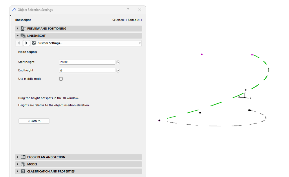

Regarding the Road Lines, is there a way to make those Nodes change their elevation?
If that can follow a mesh, I can see that one being super useful!
Thanks!

Honestly, it didn't occur to me that some people would need it in a slanted way (since 99% of my projects are on flat ground). My bad.
I re-iterated the file and it is attached. . You can edit the endpoint height in the properties, 3D etc. And you can add one intermediary height if needed.
