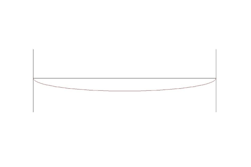

Is it possible to script a tube/cylinder to be 30’ long and sag down in the mid 2’? What I’m using it for is a swinging bridge. Or is there a better way to achieve this?

Have you ever used the tube-command? This should work with a calculated path for the tube.
... und im Übrigen bin ich der Meinung, dass Trockenbauwände einschichtig zu modellieren sind.
Frank Beister
I gave it a try. See attached object.
The solution is TUBE indeed. The shape is a cylind, the path is a parable, as we know at least since Antonio Gaudi. Which order is the most real I don't know, but I took (for not doing too much math) the second order:
y = aa * x^2
By knowing 2 Points (left and right hight L and R) and their distance (width of object A) you can calculate the factor aa by:
aa= R / ( (A*SQR(R/L)/(1+SQR(R/L) )^2

you could also make it very easily using trussmaker

I ended up going the trussmaker route and using solid element operations.
