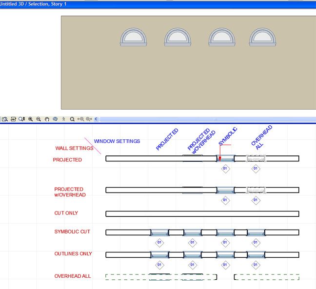

I have a wall set to projected with overhead. I then set 4 copies of a half-round window in the wall at transom height. Cut Plane is out-of the box 4'.
The window set to Projected does not show in plan with or with out a door underneath.
Is your wall set to symbolic?

I tried setting the wall to symbolic and the circle head windows to projected but it's still showing up. Tried some of you other setting above as well. I thought maybe it could be that I was using a complex profile for the wall, but that's not the case in this drawing. It's a composite structure but not a complex profile.

Wrath,
Perhaps I wasn't clear, you do NOT want your wall set to symbolic
Depending on what you want to set your wall to, then decide what you want to set your window.
See the attached matrix. I created one wall with the 4 identical transoms set with their sill at 7' AFF. Red are the wall settings and blue the window settings.
Note also that although the windows are all set to show their marker, the wall and/or window setting can over-ride their display.
HTH
HTH

That got it for me. Thanks a bunch Erika.
