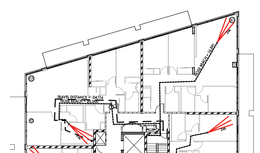

Can I make a request for the next version of your part?
We would like to use this tool to illustrate fire hose reach as well (Toronto now asks that this be shown on permit drawing in addition to the travel distances).
Hose reach is a maximum length of 30 metres and then a 3 metre (spray - see illustration).
Could you script an end arrow time that places the hose spray at the end as an option to accomplish this?

Yanni
Graphisoft Alumni
Graphisoft Alumni
I attach the latest version. For AC21. Aaron, please test the Fire Hose Reach check box.

Scott Bulmer
Yanni, I try to switch the Prefix text under Custom Settings from 'Travel Distance =' to either your 'Hose Length' or 'Custom', but the object will not allow me to alter the Prefix. Can you please help? Thanks, Scott
Attached is an example where I manually altered the text. A common fire department requirement is to show that the building can be covered by a fire hose up to 150 feet which is depicted in this attachment. I cannot get the Travel Distance object to display that text.
