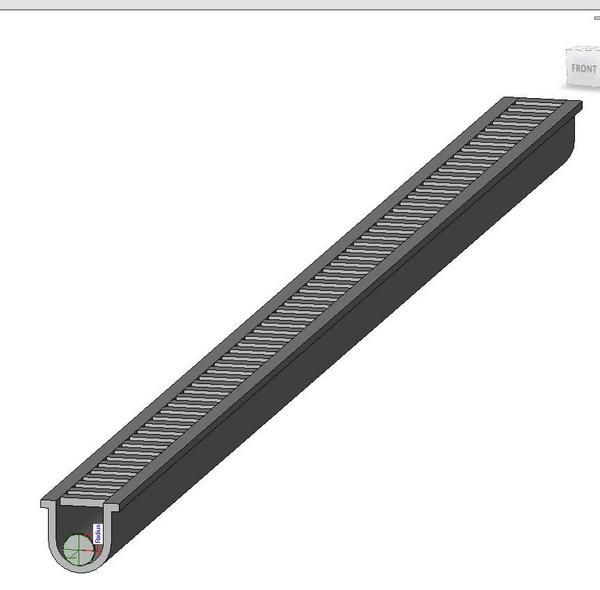

Trench Drain for ArchiCAD
Hello!
I need a drain for my project...
Carrington's one for Revit is perfect! Is it available for ArchiCAD?
If not, what ArchiCAD object could I use that can be similar? I haven't found any...
Thank you!!!
