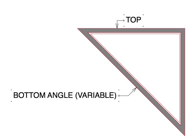

Triangle Window (Right Angle Top Corner)
Trying to create a Triangle Window (Right Angle Top Corner). Can this be achieved with the standard library?

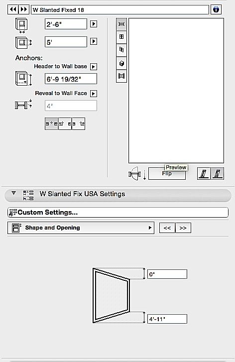

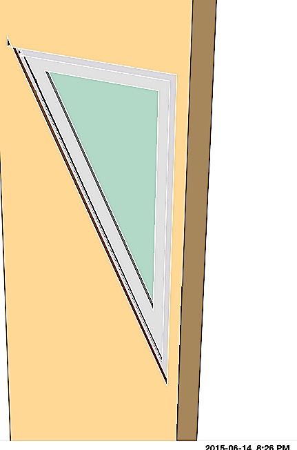

i came pretty close using the W Slanted Fixed window.

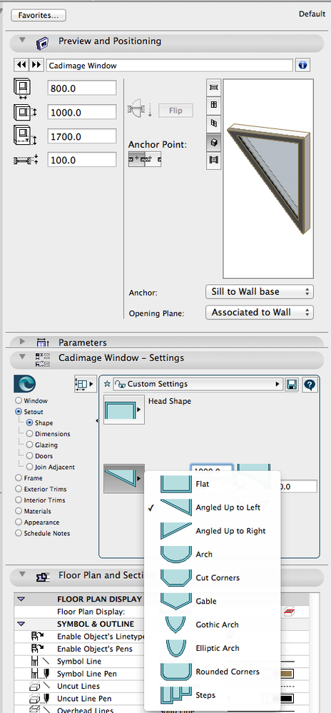

Cadimage window shown below. I should be on a commission.
Download the 'freeformwindow' from BIMcomponents.
Thanks all for the advice. Cadimage is probably the best bet. I have the free form window but a bit rusty on the interface.

CADimage is probably the best option. However, the custom window option is just fine as well.
