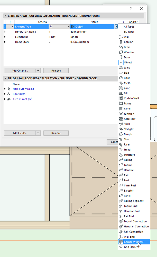

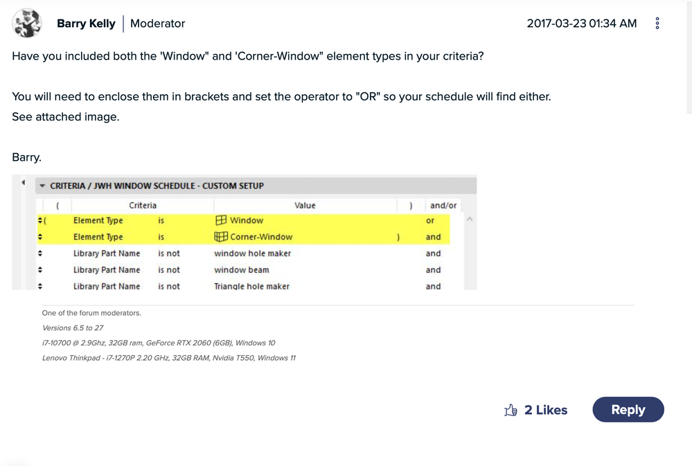

But here Barry says
That post was from 2017, I guess things have changed since then.
I just opened version 22 (the oldest I still have installed) and it is there.
In version 28 it is no longer there.
I'm not sure exactly when it disappeared.
It was still there right up to version 27.

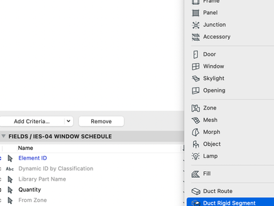

Its not there in 28, even when you choose 'Show More'.

I just checked and the element type dropdown list does not include the corner window type, but that element type value actually exists when added to the schedule.
It could be a minor bug to be solved in coming hotfixes. I wish... 🤞
