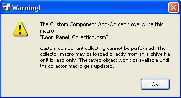

Laura Yanoviak
I was receiving the following message when trying to save a Custom Door Panel. The GSM file was from an LCF, but its source was not an archive file, nor was it read-only. I replaced the Macros as others have suggested and now it works, but something is definitely wrong here...

This seems to be a glitch with either the Custom Component add-on or - more likely - the "Door_Panel_Collection.gsm" macro. You should try the following things:
-try to reload the active libraries (make sure that the panel elements are also loaded)
-delete your Library Cache (search for a file called ArchiCADGdlBinCode.dat). It is possible that this cache got corrupted somehow.
-Check if you have more than one Door_Panel_Collection.gsm in your active libraries. This could happen if you have loaded both AC 10 and 11 libraries. In this case, you should only keep the AC 11 macro
