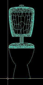

I am trying to create caroma WC library parts for future use.
I have managed to convert the dwf from caroma's website into a usable GDL object, however the automatic GDL creation has created an object that when viewed in elevation has many printable contour lines.
I only really want to see the very edge of the toilet lines in elevation.
So is there a way that i can change the GDL script to hide minor contours??
I hope this makes sense...
Thanks,
Tom

There should be an option on import to eliminate those lines. I forget what it's called. Something about smoothing or coplanar surfaces or something. I know it's there for 3DS. I think it also exists for DWG.
Thanks Matthew.
I looked into importing a 3DS file (as caroma have also modelled in 3Ds)
The promblem I have found is only one part of the toilet has been made smooth, the rest remains with contours.
Its as if the object is made out of blocks, and it can only smooth one block.
Not sure how to smooth the lot.

Are you sure that's not just the crackle finish glaze?
It seems odd. As I recall the parts I've imported have been fully smoothed. Maybe the non-smooth parts are surface models and the smoothing only works on solids (just guessing here).

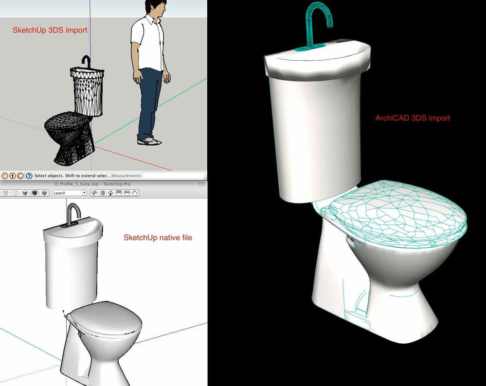

You got me curious so I took a look at one of their toilets. This one imported a little better into ArchiCAD. They also have a native SketchUp model that looks OK. On the other hand the SketchUp 3DS import is no good at all (the "merge coplanar faces" option is no help) and exporting from the SketchUp model to ArchiCAD via 3DS was similarly yucky.
Yeah , I got the same result for that toilet suite.
It seems a lot better, minus the whacky seat.

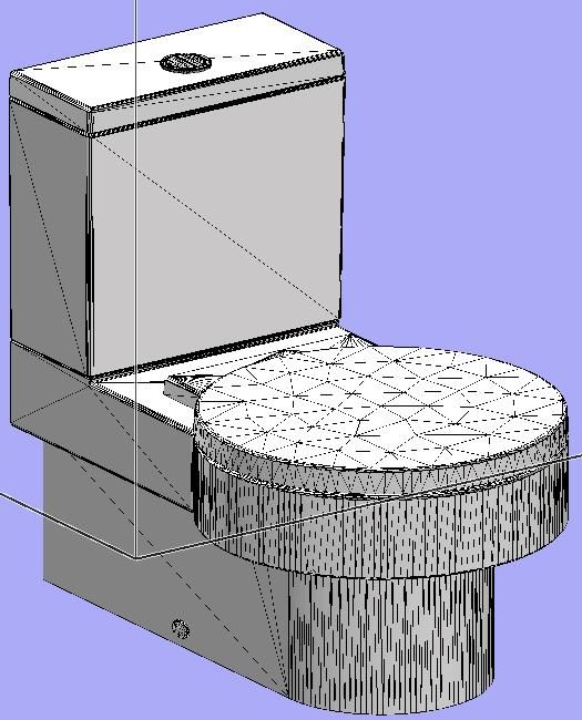

I have attached an example of one object that didnt seem to work too bad.
(Created on ArchiCAD 12)
