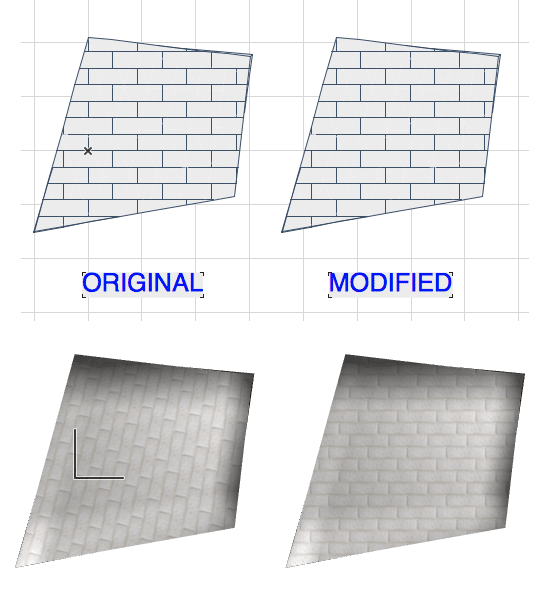

There is one problem I've discovered with the way it aligns the material compared to the way it applies the 2d cover fill. If you apply a material that you would expect to have a horizontal fill the material is rotated by 90 degrees clockwise when viewed in 3d. The separately applied 2d cover fill is orientated correctly.
The question is how do I adjust the code below to correct this?
		v= VARDIM2(ac_mesh_X)
		u= VARDIM1(ac_mesh_X)
	VERT ac_mesh_X[1][1], ac_mesh_Y[1][1], ac_mesh_Z[1][1]
	VERT ac_mesh_X[1], ac_mesh_Y[1], ac_mesh_Z[1]
	VERT ac_mesh_X2[1][1], ac_mesh_Y2[1][1], ac_mesh_Z2[1][1]
	COOR 2+256+1024, 1, 2, 3, 4
Another problem that the GDL genius's may be able to help with is when the mesh gets distorted past a certain point, the material alignment goes crazy on certain polygons. Is there a way to get it to align properly all the time, or is this just unavoidable? I notice this happens when using the standard mesh tool as well so I guess it could be a limitation on how AC deals with textures.
Many thanks!

Peter:
I took a quick look at this, and will not pretend to understand the original coder's intent. For localized texture mapping I have used the code:
Vert 0, 0, 0
Vert 1, 0, 0
Vert 0, 1, 0
Vert 0, 0, 1
COOR 2+256, -1, -2, -3, -4
If you substitute this you will get a correct result, at least on my simple test. But the original coder may have had reasons for his version, and I have not tested, so other forms created with this object (which can very tremendously) may be worst, rather than better.
From the GDL Manual:
Use a minus sign (-) before VERT indices if they are used only for defining the local coordinate system.
David
