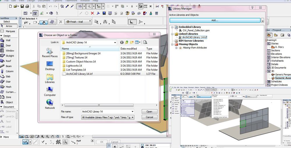

I have question when i want to turn the panel into window i can not because there is no options for it or i do not have it
how i can get this curtain wall panel type that make me create window inside curtain wall like this on the image

i made load library object but it is not work like on the image i need tips to how to get these parts

Using the Load Other Curtain Wall Panel... will not work, as the objects are in an .lcf file. You need to use the Library Manager... to add this library to your project file. If this does not make sense, then post an image of your Library Manager.

i take one window and make it in embedded library still i have problem to make the window inserted into list to do window on panel here is my image of libraray manager

The part you are showing is not a panel. You need to use the Library Manager's Add button to add the Object Library 14.lcf to your loaded libraries to use these curtain wall parts.

Thanks so much when i pressed library manager -- add -- archicad library14.lcf it works and show the list i want as in the image thank you David also for following my complains
