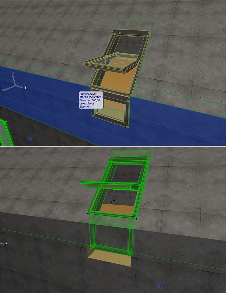

I am relatively new to archicad environment and my question refers directly to the proper implementation of the Velux libraries.
As you can see the problem I faced is that the skylight part of the window interacts with the roof and creates an opening while the bottom part which is situated on the vertical wall does not interact as it should and thus does not trim the wall.
I attach the image so you can possibly figure out what am I doing wrong.

The skylight objects only belong to the roof that you place them in which is why the cut the hole automatically there but they have no relationship with the wall so they will have no effect on it.
I was going to suggest trying a Solid Element Operation between the skylight and the wall but it seems this is not possible with skylight objects.
So you will need to manually cut a hole in the wall to suit with an empty opening.

Okay I obviously expectated that the lack of interactivity skylight - wall may be the cause which is by the way a serious flaw as the wall is the right type of geometry this kind of window should interact with.
So what I did was making a morph box and doing a substraction(does it always has to create morph and does it cause any flaws to the wall drawing wise?).
Now the problem is with offsetting the window the suggested by velux 14-15 cm away from the edge.
How come that a component does not take into consideration the very principles of the product's assemble instructions by its producer?
No it doesn't need to be a Morph.
It could be a slab or a beam or as I said before just add an empty opening window to the wall that is the correct size (no need for SEO and hidden layer).
I am not familiar with the Velux object but if you set it back 14-15cm from the edge of the roof then there will be nothing there to cut the edge away.
It would make sense that a skylight that is designed to go in both the roof and the wall would interact with both, but unfortunately the skylight tool only interacts with the roof and standard windows interact with the wall.
I am sure it would be major re-programing on Graphisoft's part to do what you wish.
But by all means make a wish for it in the 'Wishes' section of this forum - you never know what might happen.

You might want to consider modeling the vertical Wall piece and the Roof out of a single Shell element.
You can place Skylights into Shells just the same as you can in Roofs.
But the Shell can be an extruded polyline profile so you just draw the profile of the Wall piece and the sloping Roof piece and it creates a single element.
Then you can even place holes into it if the Skylight does not cut its hole properly.
Probably easier to manager then Wall+Roof, plus the Floor Plan representation of Shells is based on a true 3D vertical projection.
