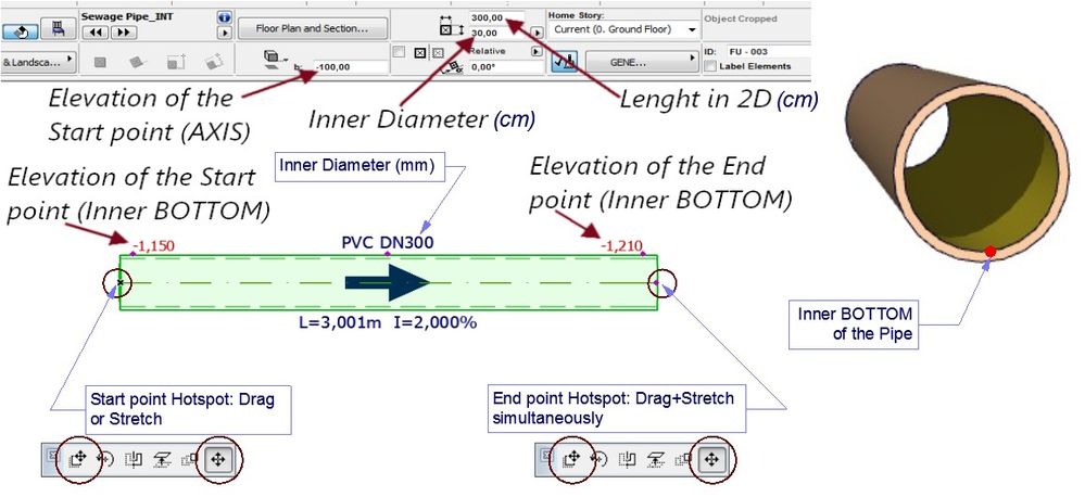

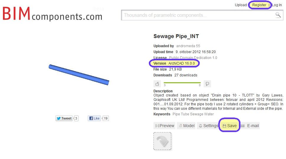

Certain time ago I made an object for this. Take a look if it is useful for You.
For download:
