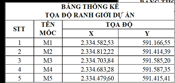

I have a site plan drawing in AutoCAD with the point coordinates already defined. I have inserted this plan into a worksheet already. How can I align/match the coordinates of this plan correctly in Archicad?

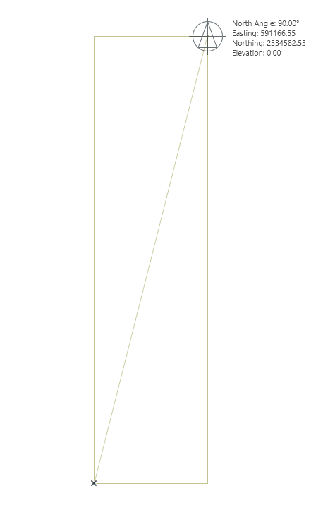

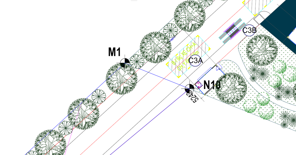

I inserted the CAD file into the worksheet and then traced the reference into the plan. In the worksheet, the CAD file aligns correctly with the floor plan, and point M1 is set as the survey point. However, in the Plan, there seems to be a discrepancy between the (0,0) origin and the (0,0) point of the worksheet.
Also, what is the best way to model this conveniently? If the survey point is too far from the origin (0,0), the modeling process becomes difficult. Is there any way to handle this issue?

You have coordinated points, so ignore the DWG origin. Move the reference closer to your Project Origin and trim the frame of the reference. Modelling far from origin will cause all sorts of issues... The origin of your worksheet not aligning to that of "model space" is possibly one of those issues. If after you have trimmed the reference and shifted the DWG closer to the origin, it is still offset, try setting your trace location.
View => Trace Options => Reset to Default Location

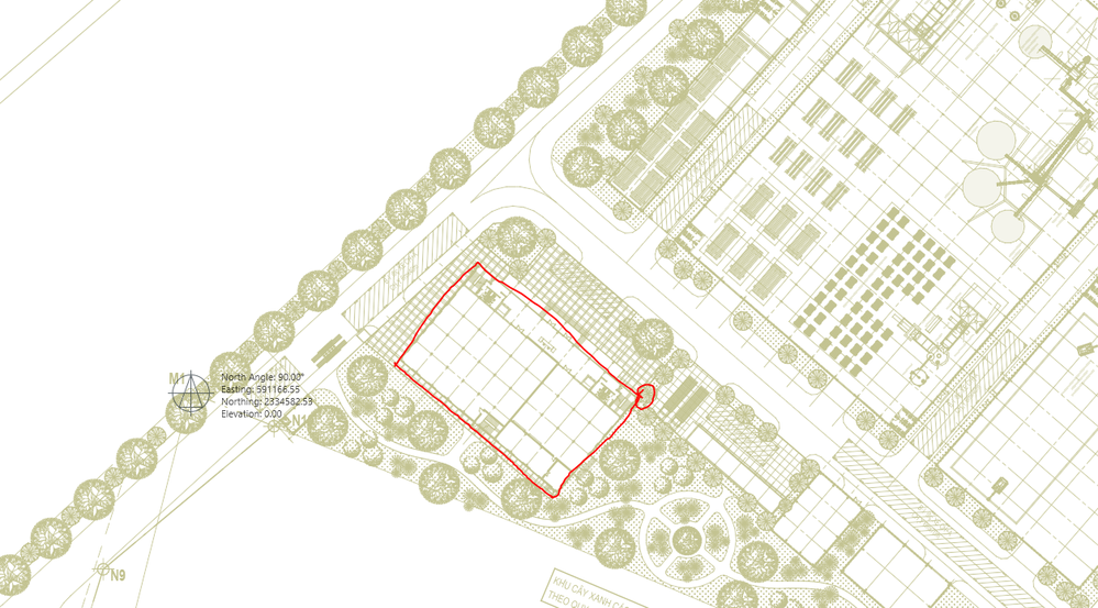

As shown in the image, the master plan file already has the CAD file attached, and the Survey Point is set very far from the origin (0,0) of the master plan file.
Next, for example, I create a separate PLN file for Building A in the red-circled area, and the origin point (0,0) of Building A is set at the corner point marked in red.
How can I align and place Building A correctly into the master plan?

Not really, but it's kinda easy. Let's take the hardest example: multiple buildings with different story heights, rotated, etc.
How i do it:
0. Prepare the site plan. This will have everything aside the actual buildings: terrain, roads, sidewalks, landscaping, etc. You will need to have a position for you imported models ready. I usually set a worksheet with a siteplan as trace reference, but other methods can work as well: 2d contour of buildings, hotspot the corners, etc.
(OPTIONAL) Link as discussed before, using survey point, if you wish to export an IFC of the whole project in absolute coords. Best way to work here is north facing up, as Archicad has a rotation you can add to the survey point, but in my experience it's always a fraction off. If you want TRVE perfection, go north facing up.

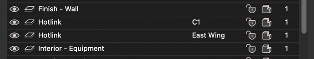

1. Prepare for building hotlinking. Create a layer for each Building, so you can easily turn them on and off, if necessary. This depends on your template, but i usually add extensions for this.
