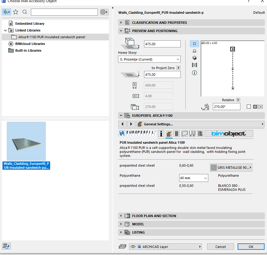

So this is how I use them..
I downloaded the first one from this manufacturer https://www.bimobject.com/en/europerfil/product/atica_1100_pur
  • Add it to your Library manager
  •  Draw a wall, select it and follow the path
  •  select your panel and customize it as you want
  • Then your cursor  will be like an angled eye so you select on which side of the wall you want your panel (sorry, dont know how to screenshot the cursor)
 Taa-daa

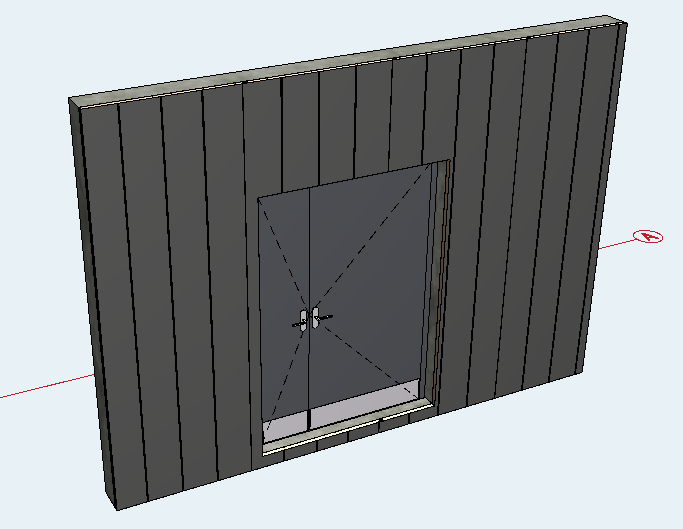

  • When adding windows/doors you place them to the main wall like this
  • accessories will follow any modification of the wall
  • You can play with other libraries and objects from  bimobject website, but they pretty much work the same.
Hope this helped!

I use wall accessories for this
here you can download a lot of sandwich panels: https://www.bimobject.com/en/categories/walls/sandwich-panels?native=true&software=archicad&sort=dow...
Here you have a tutorial how to apply wall accessories: https://community.graphisoft.com/t5/Modeling/Accessories-Add-On/ta-p/303775

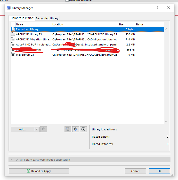

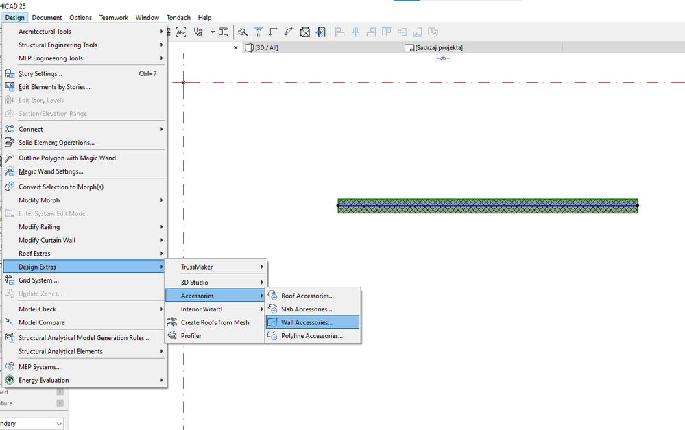

Kikoria
Cool. I've downloaded "Goodies" add-on. I am using Archicad 25 and where can I download the accessories library elements? Because when I go to the accessories settings, it's empty.
Kind regards,
Tamaz Kikoria
Architect
Technical Examination and Design Department
GEORGIAN WATER & POWER
You should find you now have an 'Accessories Library' in your Archicad 25 program folder which you need to load in your Library Manager.
Kikoria
Thanks a lot!
Kind regards,
Tamaz Kikoria
Architect
Kikoria
One last question; How do I add the sandwich panel object downloaded from the BIM site to the accessories library?
