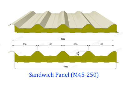

Hi everybody. I was wondering, can I create sandwich panel by using wall tool?
The panel looks like this:
I built it using railing tool. It was easy, but I couldn't create an opening inside of it. Then I tried to dig into log wall but couldn't get the desired result. Is there any way in the wall tool to make sandwich panel like this?
