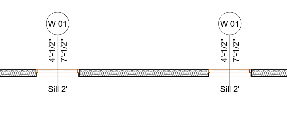

I find the W Marker 19 for windows useful for certain kinds of projects. In the settings window it is possible to hide the Marker on Plan. The problem is that, to do so, I have to select every individual window and then hide the marker. I tis convenient to have the Marker show on 1/4" Part Plans of the building, but not on the main plan that shows the whole building because it is at 3/32" and if W marker 19 shows, then the whole plan is an unreadable mess - too much info. Is there a way to set up a layer combo to address this problem - I can't seem to get it to work because the marker appears to be dependent on the window.

Model View Options
I use both Labels and Dimension Markers for doors and windows.
