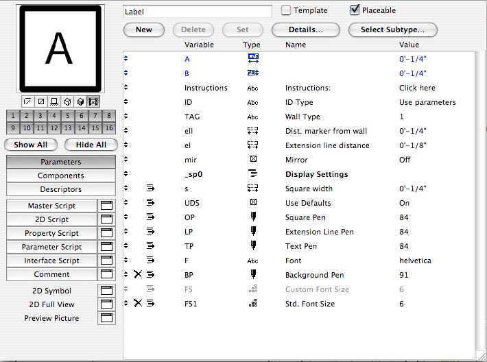

I'm having a little difficulty applying a background fill to a wall tag that I'm using. The tag that I'm using is a modified version of Eric Batte's wall tag part. What is the line of code that I can add to this part to add a solid fill inside the rectangle to block out the drawing elements beneath the tag?
Thanks for your help on this!
ww=wall_direction add2 label_position [2][1]+label_position [3][1], label_position [2][2]+label_position [3][2] IF ww = 180 THEN ww = 0 IF ww = 270 THEN ww = 90 ROT2 ww+90 IF mir=1 THEN rot2 180 PEN LP SET FILL BP line2 ell*A_,0,-el*A_,0 HOTSPOT2 ell*A_,0 HOTSPOT2 -el*A_,0 If UDS=1 THEN FS=FS1 ENDIF PEN OP rect2 ell*A_,(-s/2)*A_,(ell+s)*A_,(s/2)*A_ HOTSPOT2 0,0 HOTSPOT2 ell*A_, (-s/2)*A_ HOTSPOT2 ell*A_, (s/2)*A_ HOTSPOT2 (ell+s)*A_, (s/2)*A_ HOTSPOT2 (ell+s)*A_, (-s/2)*A_ rot2 -90 add2 0,(ell+s/2)*A_ rot2 -ww if mir = 1 then ROT2 180 PEN TP DEFINE STYLE "AC_STYLE_1" F, FS*25.4/72, 5, 0 SET STYLE "AC_STYLE_1" HOTSPOT2 0,0 TEXT2 0, 0, T

Thanks for your reply. My GDL knowledge is pretty basic, so I'm not sure where to start with your suggestion. How would I modify the current script with the new command to produce the same output only with a solid background?
Thanks for your help!

Looking at your rect2 command, it appears that it will not
draw a rectangle but a straight horizontal line.
Is this what you see when you go to the 2D full view window ?
Both "y" values are the same. They must be different to draw
a rectangle. I do not know what that second
"y" value should be because I do not have the parameter
list or Master script for this object. I also can't write a poly2
command that draws a rectangle for the same reason.
Peter Devlin

Thanks for continuing to look into this. I looked at the y values you were mentioning and, correct me if I wrong, but isn't one y value negative? Also, I've attached a couple of screenshots of the parameters list and the 2d full view.
Thanks again, Peter!
Brian

Right you are. I missed that.
Comment out the rect2 command like this.
PEN OP
!!!!rect2 ell*A_,(-s/2)*A_,(ell+s)*A_,(s/2)*A_
Write this below it.
poly2 4,7,
ell*A_,(-s/2)*A_,
(ell+s)*A_,(-s/2)*A_,
ell*A_,(-s/2)*A_,(ell+s)*A_,(s/2)*A_,
ell*A_,(ell+s)*A_,(s/2)*A_
Peter Devlin

Sorry it should be
poly2 4,7,
ell*A_, (-s/2)*A_,
(ell+s)*A_, (-s/2)*A_,
ell*A_,(s/2)*A_
Peter Devlin

I incorporated your code into the part, but still no opaque background. I've attached a screenshot in case I've transcribed something incorrectly. Any suggestions?
Thanks,
Brian
