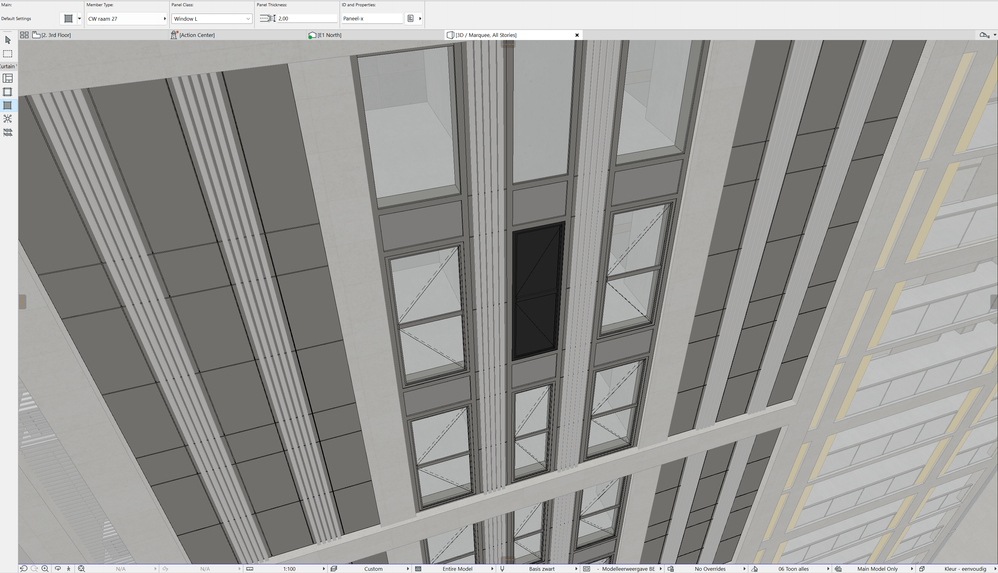

my problem with the Curtain Wall Tool started to occur since yesterday.
when I try to fill an empty spot in my curtain wall with a CW window, or when I change the type of window, the whole object suddenly turns black. However, when I check the preview in the settings everything looks fine. I tried everything, the overwrite options, I checked all the settings for mistakes and eventually even resorted to redrawing it but the problem stays the same. For some reason this occurs to all the CW windows and CW doors member types.

Yes, that's what I mean. When I place a new window on a previously deleted pannel it turns black. But this also happens when I edit or replace an existing pannel. It's really strange. I have a feeling it's a bug. Since this is happening in two different projects I'm currently working on. And it always happens when I try to change a CW window or a CW door.

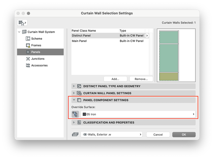

Check the Panel Component Settings, it could be set to Override Surface. This panel may be hidden, so check your Work Environment > Tool Schemes > Tool Settings Dialog Boxes > Curtain Wall Panel Tool to see if it is visible. It looks like is is set to hide in the standard Work Environment.
