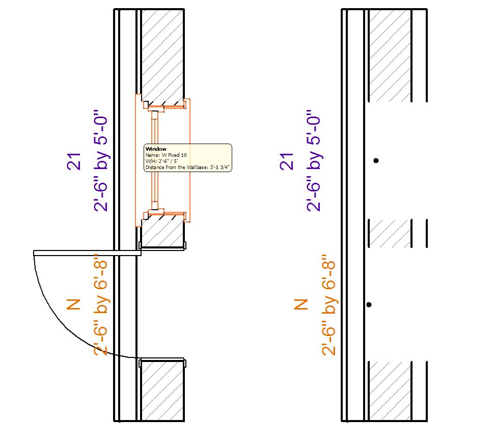

I have just started making some custom wall profiles.
I am not able to put windows and doors into them without being informed that there are scripting errors.
It happens with the custom wall profiles provided by Graphisoft as well.
The window is there in 3D ok. 2D shows up a bit strange. If I attempt to mess with the window I get scripting error alerts all over.
Is there something simple I am missing before I wander any deeper into this?

I opened a new file and drew an archicad profile wall (brick wall w/ molding).
Window works like a charm. If I use a profile wall that I have made, 2X6 stud wall with skins... no go. A black dot appears as though a library part is not loaded. It is there in 3D but in 2D it is missing, although the marker is there and an empty opening.

Here is a screen shot.
I made a new file using AC10 Standar template. AC10 library loaded.
All fine. Using the supplied profile 'brick wall w/ molding' on left. That works fine.
One on right is a copy of the original profile the difference is that I have added another fill to the right to represent a sheathing 'skin' or what have you. Large for display purposes. As soon as I add that extra fill via the profile editor and store profile the window / door go buggy. Script error. If I switch back to the other profile the window / door work again. The only difference is the addition of a fill in the editor...
I just copied / pasted the wall fill and moved it over (changed fill type so it is visible). Does it every time.

Made two profiles from scratch.
Profile C w/ one fill works sort of (if I try to change the window fill from the AC loaded one to empty fill- bugs out).
Profile D three fills in editor no works at all. I can change window parts, whatever, doesn't work.
Profiles A has gone buggy in the interim of it's own accord. Has not been modified at all since first screen shot.
So, I give up... This should be easy right? Anyone out there able to replicate this or am I in some twilight zone (archicad) alternate dimension?

Trying to keep this thread alive. I can make this error happen every time.
Anybody else?
Even if I select a current composite wall and convert it to profile it immediately loses it's doors and windows... every time, all current AC10 library...
