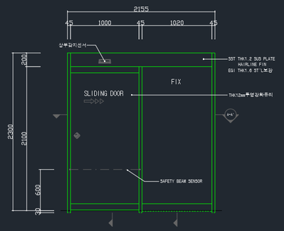

LeeJaeYoung
What are your automatic or semi-automatic sliding doors made of?
It would be nice if it could be expressed with the sensor and the open button.

I asked a question about what can be made of that door in archicad.
I'd like to know how far this is possible.
Except for modeling. (This is because the variable cannot be used.)

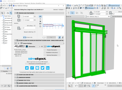

I would model it from slabs flat on the floor and then save as a door object.
It won't be parametric, but you will get it to look exactly as you want in as much detail as you want (i.e. sensors and buttons).
Otherwise if you want a parametric object, there really is no other choice except for you to script it yourself in GDL to do exactly as you want.
Free parametric BIM Models of "automatic sliding door" in GDL, 3DS, DWG and DXF formats (bimcomponen...   Like this ?
