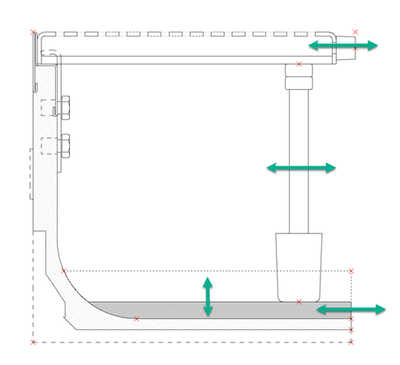

My example product is a pre-formed strip drain / channel product (typically run around the edge of a building and across doorways where exterior paving needs to be level with interior floor level)
Each of the elements with green arrows in the screenshot below needs to be adjustable inwards or outwards within specified limits to deal with local variations in building wall position (to deal with inset doorways, or variations in cladding thickness etc), even as the other edge of the assembly remains fixed.
There is a layer of grout at the base of the channel with thickness that needs to stretch upwards or downwards as well, depending on its falls along the channel base, as this is reflected in a given location, with the grate support stanchion adjusting in length to follow the grout.

It makes sense, it all comes down to workflow in another sense I suppose. I would typically make 1 principal detail and specify that the dimension may vary.
Param-O is for 3D objects only, as far as I know, so fragments in GDL is probably the right way to go.
Rule of thumb I use is: how often will I re-use the part (how often does it repeat in the project or am I likely to need it again). Offset the time 'wasted' on dealing with dumb 2D lines v.s. the time spent to make it into something parametric.
For 2D parts I generally just keep them as dumb lines as it does feel tedious to make it work.
Edit: also consider a simple hotlinked module sometimes for details. You can have a little 'workshop' assembly off to the side and make some easy stretches and save a few modules to populate your details with.
