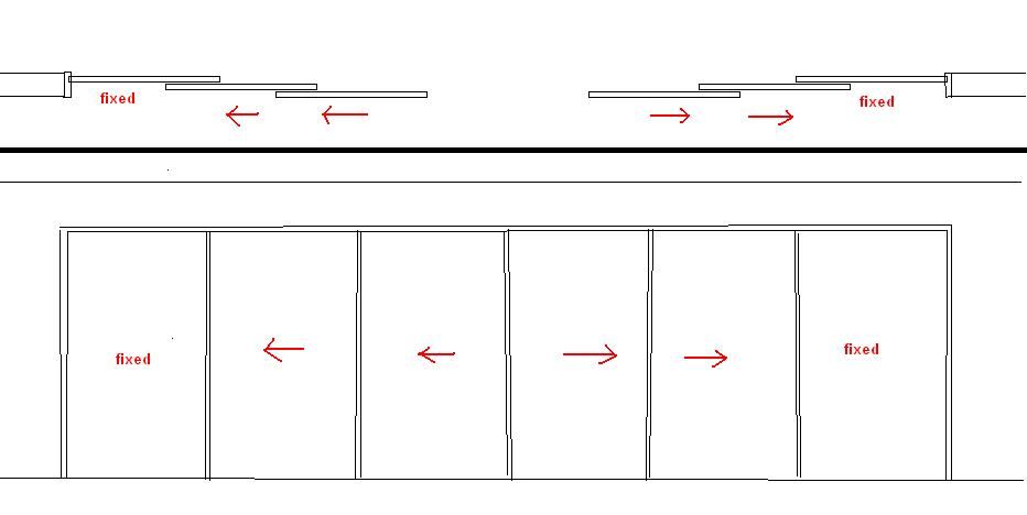

Where can i find a stacker glass door
im trying to find a stacker door like this....
6 pannels. 4 center ones open, 2 to each side.
i can only find stackers that stack to one side.
also after a corner stacker door if theres one aval

I've tried to create one... many, many years ago. I find the best solution is to create an empty opening and place in individual doors. Save an EMPTY OPENING with all the SCHEDULING PARAMETERS so you can use it in your schedule.
It's a crappy answer for sure, but seems I have less and less time to dig into gdl anymore.

You can do this with CadImage Door & Window Builder easily. I have never tried a corner one but will give it a try and let you know.

no question: cadimage door and window builder.
(regarding the corner condition - i've only been able to produce one with a corner post. you can model it without so that it appears the whole corner slides back, but this involves butchering the plan/elevation/schedule. i have the same problem now for the building in the screenshot. i've been trying to figure it, but no luck yet...)

get David Sanders door objects from the object depository here, he has made a great one. you may need to rescript some of the pen settings to conform to your pen sets, though.
yeh i have that.. it has a door like what i want but is a pocket door..
He must have posted an update, my set has both a pocket and a stacking slider. there is a missing trim macro though, but that is easy to fix
