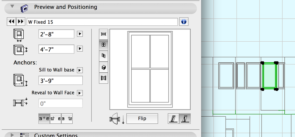

Why are my windows showing incorrectly on elevation view?
I've never had this happen before.. Window settings are all correct, elevation view settings are all correct but the H-V Grids on my windows aren't showing on my elevation views. They show on 3D View and in Settings (photo attached) but not in elevation. Doors are okay, it's just windows.
Archicad 18
2 Replies 2
Does this same problem occurs if you use a v18 Window instead of a v15 Window? Just want to check that it is not because you are using a GDL object from 3 versions earlier that is causing the problem.
GDL is changing from version to version so some GDL objects may not work properly when used in later versions, for which they were not originally scripted.
Are the grids only on one side of the window?
