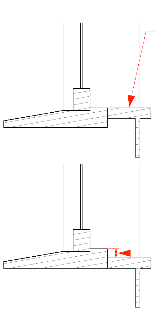

The top of the interior window stool currently matches the top of the jamb extension.
A "Stool Offset Distance" parameter is needed to move the top of the stool down from the jamb extension.
If possible, could GS post an window update(s) here for download that adds this parameter to windows? Kind of a quick fix thing.
It would be a great help right now.

I would post a sketch explaining exactly what you want ...
Djordje
ArchiCAD since 4.55 ... 1995
HP Omen
MSotero
The top image is a section using a standard AC10 Template Window.
The lower shows the needed offset parameter.
I've also noticed that the inside Windows Frame profile is drawn with
the Wall pen instead of the parameter pens. This also happens with doors.
It would be nice to have them fixed. Or maybe I've overlooking something.
