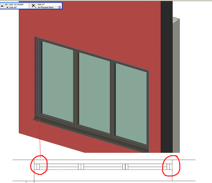

Any ideas on how I can get just the window frame to show up and not the sash frame? It does not appear that I can turn off the sash in the window options. Before AC10 you could set the sash frame width to 0" and it would be ok. Now it appears that AC10 objects think the object is degenerated when you do that and it wont display.
Any ideas?

Never mind, figured it out right after I made the post. Set the vertical spacing width to whatever is desired and then making the sash width 0" doesn't degenerate the object. I do not know why, but it works.

Ok, so maybe I didn't completely figure it out. It appears the option for vertical spacing does not exist in all window options. So, in a fixed window, I still don't know how to get the sash frame to disappear.
