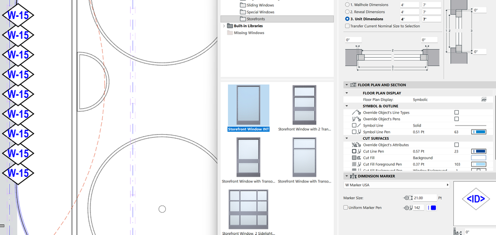

I am wanting to place a storefront  I picked a storefront window  And it acts as a single pan window   it will not ask how many panes and if any variation.
So my model shows 30 Windows side my side
  1. the frame should be 4" so I get 2 frames between each pain of 8"with a joint....or two 4" frames
  2. plus instead of one window label I have ne on every frame (without faking it)
    Operating system used: Windows 12

That is correct.
They are just single windows that you place side by side.
There may be a 'ganging' option somewhere so frame don't overlap - I am not sure as I don't use these windows.
You might want to look at 'curtain walls' as you have labelled your post.
These are a continuous pattern of frames and panels that will fit any length.
