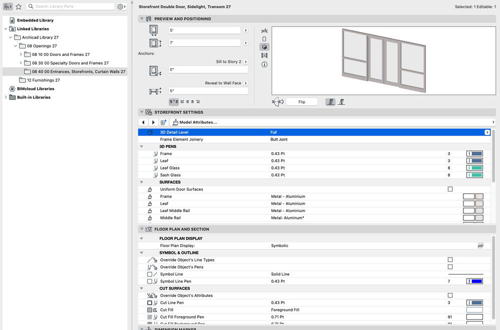

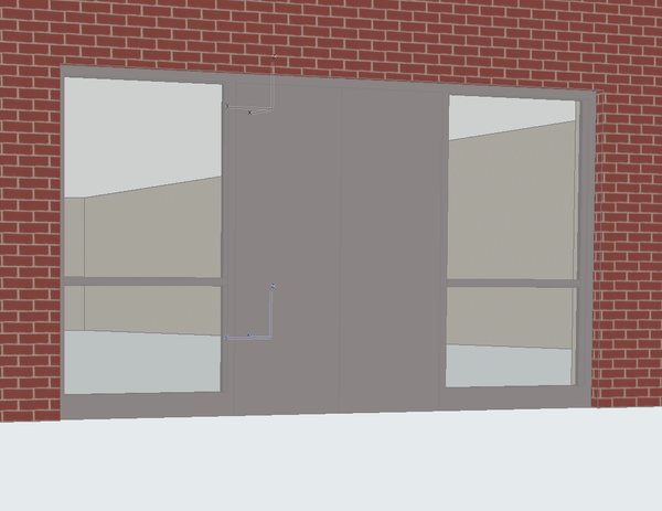

I have several variation of the same storefront object placed in my file and everything looks fine in the preview window and then when I place them each of the leafs are just solid. No frame, no glazing, no mullions. I cannot trace why, nor can I change their appearance. Any suggestions would be welcomed.

Check your Model View Options for the Level Of Detail for doors and windows.
Set them to 'Full'

Yeah, the model view was set to a different profile for some reason. Just now getting back into AC after a decade off. Thanks for the tip.
