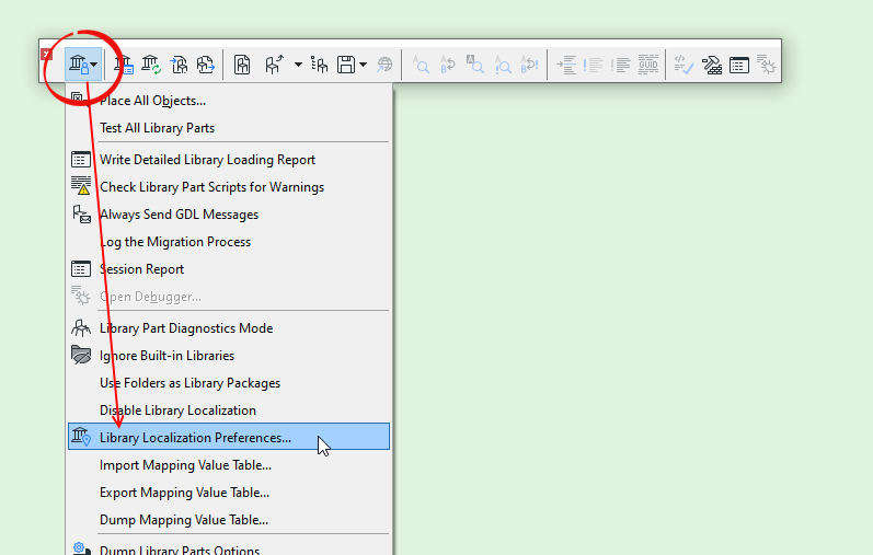

Your 28 template would have been set up to use the USA localisation.
You 27 file that you have converted will not.
Open the 'Edit GDL Library Parts' palette and find the 'Library Localisation preferences..'
option.
Then add USA to the preference list.
Now see what happens.
I am hoping that is it.

Solution
option.
Matt-Northgate
Thank you Barry! Fixed it perfectly.
I really didn't want to have to re-do my template from a stock 28.
Very very helpful!
