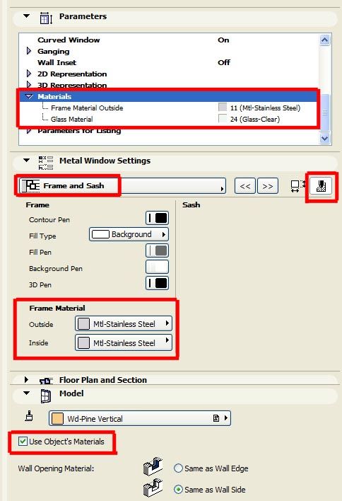

Thanks a lot i found it under metal winndows but i cant change the material.
i want it to be wood. Help
Where have you tried changing the materials?
The materials can be adjusted in the settings dialog in both the Parameters section, and in the interface section under 'frame and sash'.
Make sure you have 'Use Object's materials' ticked as well, otherwise the whole object will be a single colour!
(This screenshot is from the AC13 version. The AC10 version might be slightly different.)
