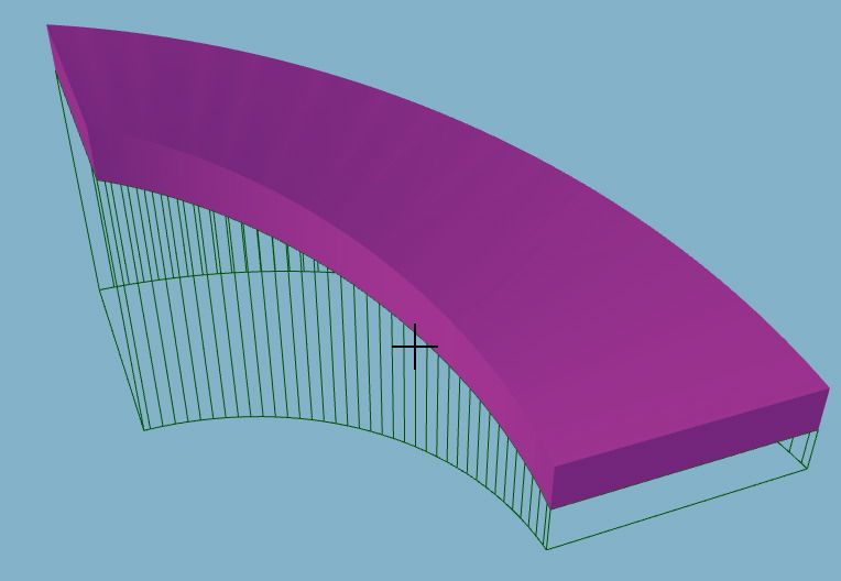

And, for irregular ramps, or flared ramps, the MESH tool is the finest, since, for any given arc, it will make an even rise.
The attached image shows a mesh ramp, the mesh ramp duplicated and dropped 3', and the top ramp SEO'd by the lower ramp to make a uniform thickness.
