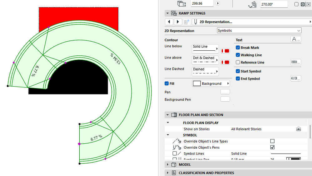

I would like to ask if it is possible to make the cover fill of this ramp object non-transparent. Currently, the fill appears transparent, and I would like it to display as a solid cover fill in the floor plan. How can I achieve this

Hi. It is possible to make the fill opaque.
Also, you might want to make sure you don't have a graphic override on that changes that setting.

if it is transparent, but the fill is set to have an opaque fill type/pen number, then it could be a graphic override or renovation filter override changing the cover fill or drafting fill to be transparent.

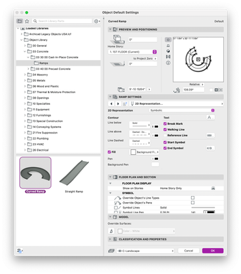

which library part is that?
in this object, there are settings for fill type, and fill foreground/background: 
(Edit: seeing this is likely the same object CosminF shared)
