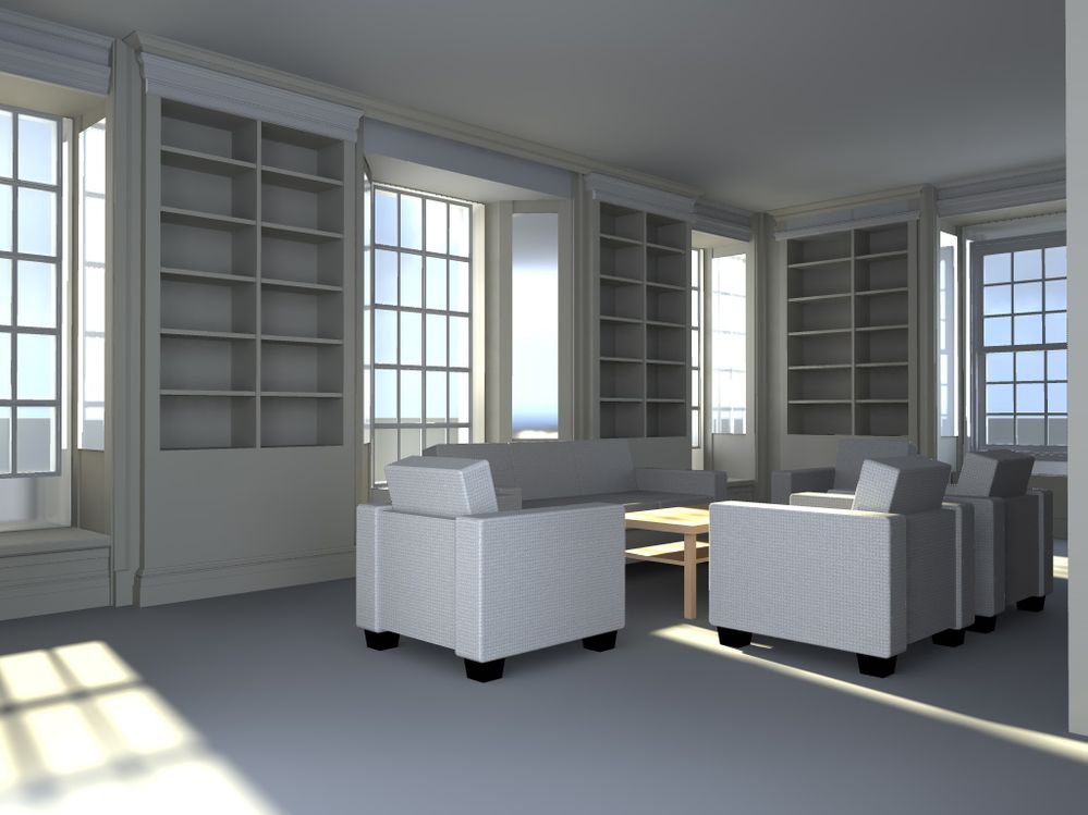

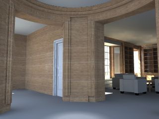

thanks alot for your help but im not sure as to what you mean about laying it flat on the floor? attach is an image file that may help you see what i am trying to do.
matthew,
as you can see i am messing with some complex moldings that need to rap around the door a certain way. i attached other test rendering that i had done

You can lay out the parts flat in the plan view and "Save as..." a library part. This won't help you with the curved openings. It looks like you are using rosettes at the corners so you could use columns at the sides and a profiled wall (for the curve) at the top.
Some of the solutions I have suggested can get a bit advanced. I would suggest you start out playing with the profiled elements (walls, columns and beams) and see what you can manage.
The best solution if you have the budget for an add-on would be to use:
OBJECTIVE
ArchiForma 2
3D Profiler
