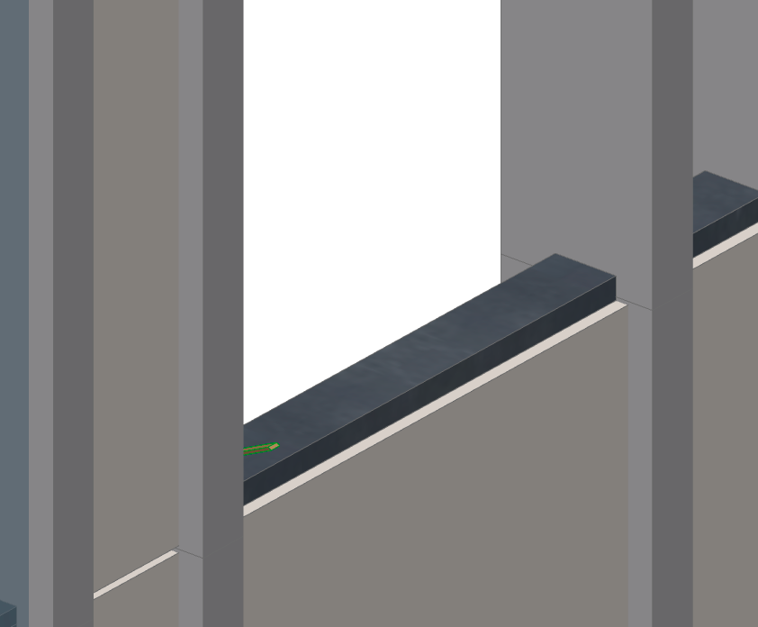

I am looking for a way to modeling a "shutter" as a wall, by using the curtain wall possibilities, precisely by rotating the panels to let the light passing through.
I "GPLed" a "rotx 45" block that i saved as a curtain panel object... as you can see, the result is not obvious.

May someone help me?

Thx you for your answer!
i put a sample picture of what i want to obtain; beside, my panel with a "rotx" parameter unfortunately in the wrong direction.
So, i have to change the origin of the object, and i hope it will be good!
