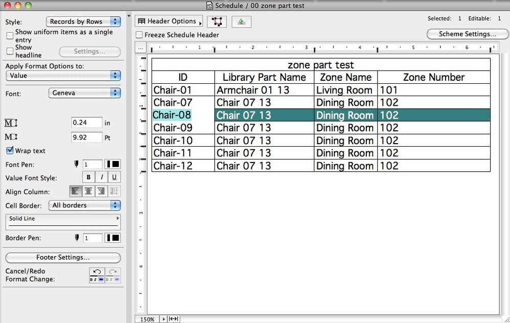

If you need to find parts by their IDs you can use Find & Select or the Scheduler. If you use the listing parameters you have to use the scheduler.
BTW: The scheduler is a great way for managing instances like this. I use it all the time to make sure that wall, column, door IDs, etc. are all correct. It also works with zones, which seems particularly useful in your case. You can run a schedule of all the parts you want to ID including their zones (rooms) and you can edit the IDs right there.
I have attached a screen shot of the scheduler with a couple of zones and some chairs.
