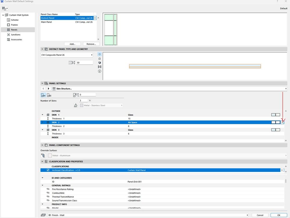

Can someone confirm that in 26 when you choose curtain wall at the panels tab  if you choose CW composite panel you cannot acces the materials tab of the skins.  You press the "arrow key" but nothing happens.
I tried this in a new file with the default addons loaded, INT 4019 update. In 25 it works perfect.
CW.jpgi have a project full of curtain walls in 26, imported from 25, an dI realize now I cannot edit them. This is a problem.

Hello, someone shared a similar issue here: https://community.Graphisoft.com/t5/Design-forum/Unable-to-set-CW-Composite-Panel-skin-building-mate...
It was confirmed to be a known bug and will be fixed in the upcoming update for Archicad 26

Thanks. My local reseller confirmed this also. I realized this 1 month ago when I started using 26 but I posted it only  couple of days ago. Glad that till early next year we will have a fix.
