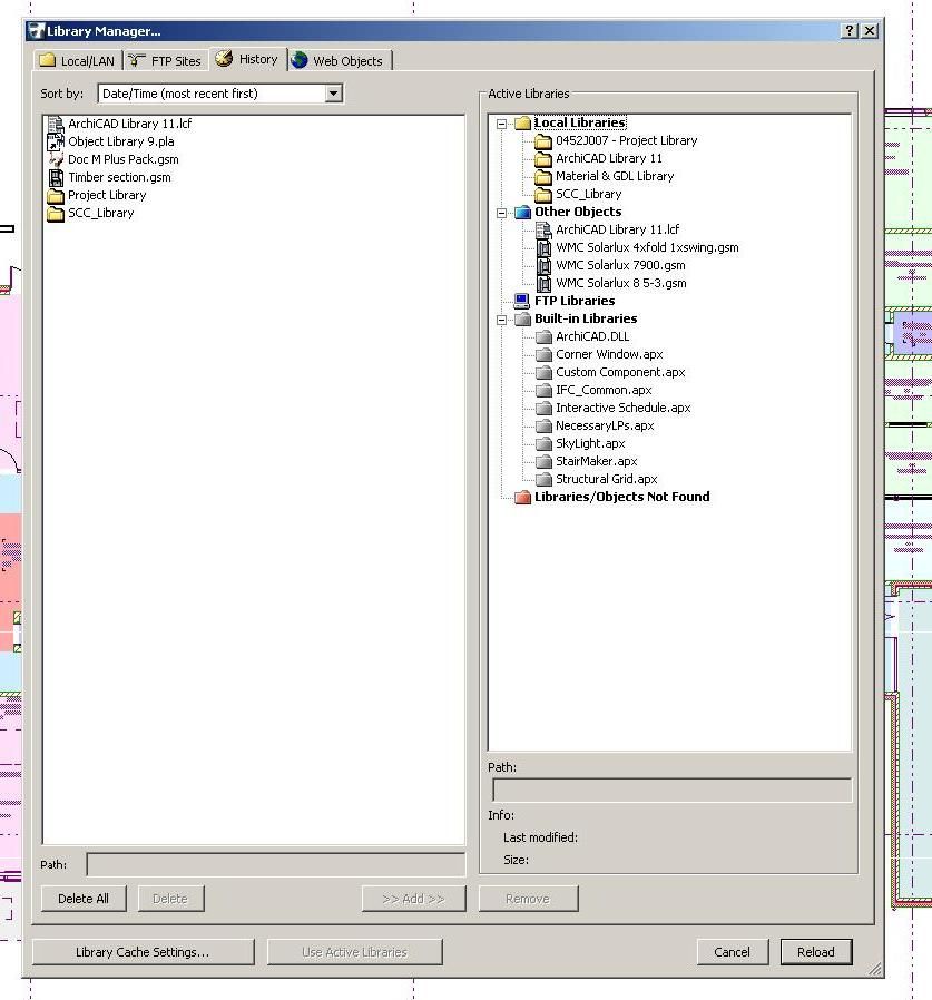

i've looked in library manager and i cant see roofmaker, where do i find it?
in the library loading report, it doesnt let me delete any duplicate objects from there?
Percy,
Post up a screen shot of the report. It might be useful to see a shot of the library manager showing what libraries are loaded also.
You will need to go into the library folder manually outside ArchiCAD and delete the one you don't want.
heres the screenshot, i'll have a look in the library folders to see if i can find this other roofmaker
Erika Epstein
you have two archicad 11 libraries. One is a folder in the top section, the other is the archcad 11.lcf. This latter one is the one you should remove.
If you open up the folder archicad 11 you will find another archcad 11.lcf

Ha, Erika just beat me!
Yes, select the lower Archicad library 11.lcf and hit the remove button.
It would also be beneficial to place those extra 'Other Objects' that are listed underneath into the correct folders to stop them getting lost in the future. There shouldn't really be any 'other objects' listed in a well organised library.
OK i've done that but now i have 3800 duplicate objects, and still get the roofmaker error!
the CADimage error seems to have gone though.
i'd like to lose the roofmaker error because it makes signing in and signing out of the teamwork project take longer (as if it doesnt take long enough lol)
