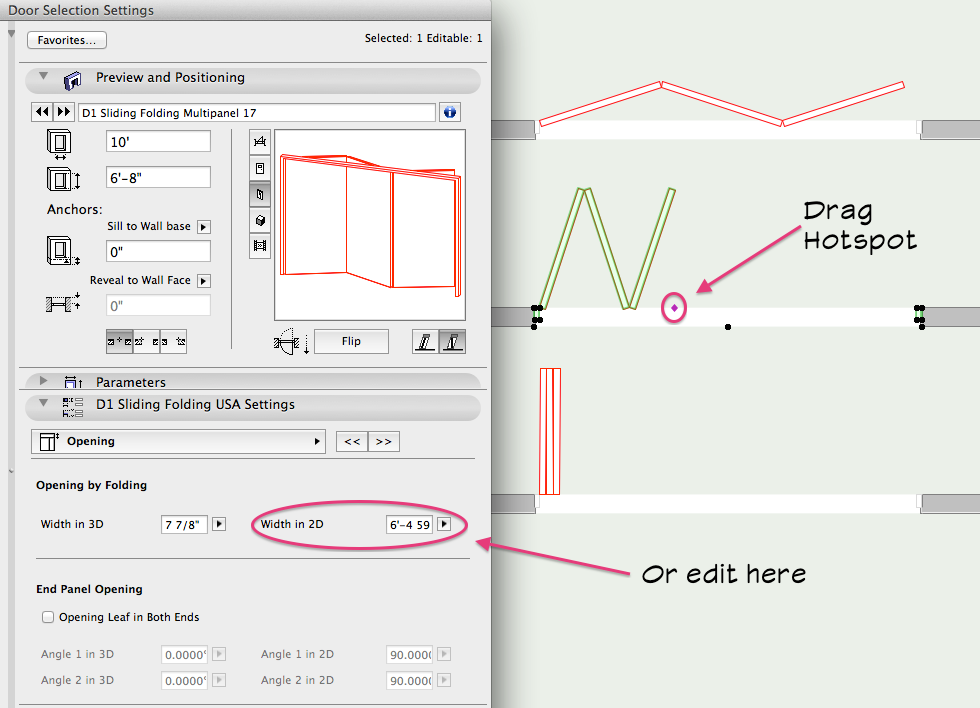

Are you using the "D1 Sliding Folding Multipanel" door?
Like Barry says:
Check the object parameters.
Like Barry says:

Thank you for both answers.
After the first answer, I found it simpler to draw the door. Then I saw the second answer. I downloaded and checked the D1 door. It does indeed what I wanted. But I don't think that all folding and sliding doors have an Opening width parameter, as this one does.
