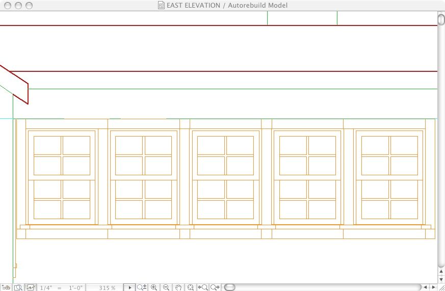

We have a problem with the exterior elevation view as well. The ganged windows look good in plan but in elevation the trim extends past the next window and there is a vertical line at the end of the trim. We gang both sides of the interior windows and one side of the two end units. If anyone has a recommendation as to how to get these lines to go away automatically, please let me know. An image is attached.
Thanks!

Tom Krowka
I've tried and tried and can't seem to get ganging to work. I turn off all the ext. brick molding and insert and "architrave" object around the window which acts as the trim. It's a library object.

jshuether
I discovered that the trim on the ganged windows extends past the window when a solid elements operation was performed on the wall containing the windows. I think my work-around was to use "trim to roof" instead of SEO "subtract with upward extrusion". SEOs are such a love hate relationship....especially with meshes!!

I have exactly this problem, and my solution has been Trim to Roof, as well.
Until now.
I have to SEO the wall containing the window to an element other than the roof, and BAM the window trim ends go wild.
Has anyone else had this problem?
Is there a good solution?
Is it a bug?
Thanks--!

jshuether
My work-around is to do a SEO on the wall to subtract the window trim that has gone haywire. It works, but it is a pain in the design phase when I am still moving windows around and I have to remember to move the SEO operator (which is always on a hidden layer).
As far as windows and doors are concerned, the wooden windows and doors that are in the ArchiCAD object library are the best that I've used despite their shortcomings and bugs. The metal windows, however, are insufficient--I have had to script my own parametric metal window to allow for any combination of fixed and operable sashes to avoid having to gang windows.
