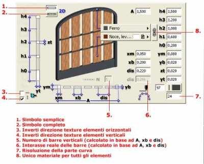

Hi Achille,
Have a look at this one in ArchiRadar. I didn't try, but I think this is what you want.

Thanks for the replies!
@Braza: No it is not what i was looking for. It is an object, not a door, so it is not inserted into the wall etc. Thanks though.
