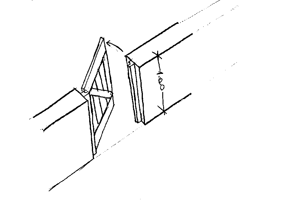

Is it possible to have a door without the top frame?
I need to place some doors in exterior spaces (gardens etc) that are only 1 meter high, and i dont need the top frame, just the two side frames (see attached sketch) Is it possible?

Hi Achille,
Have a look at this one in ArchiRadar. I didn't try, but I think this is what you want.
Erika Epstein
There is a hinged gate in the library under special doors, will that work?

Achille Pavlidis
Thanks for the replies!
@Braza: No it is not what i was looking for. It is an object, not a door, so it is not inserted into the wall etc. Thanks though.
@Erika: Where is that door? Under Special doors, i have Arch Top, Bifold, Garage and Sliding doors but inside them there is no hinged door.(?)

If you not important to use the door tools you can use object shutter style 4. Make the hole in the wall and add shutter.
Gergely Feher
Hinged gate is only available in the US library now.

One more way for garden gate. You can use Curtain wall for this task.

I was able to email the gates to Achille.

Achille Pavlidis
Yes!
Thanks Erika!
Sigitas, thanks great tips!
Gergely, i think this gate should be available to the INT library also.
