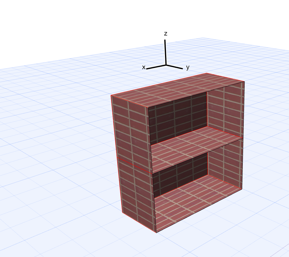

Still working on this problem...
Actually created a complex form using VERTS, EDGES and PGONS...
Seems to me that only primitives and PRISMS behave well regarding the 'solid 3D' and section Fill issue...

this gives a 'non solid' object without a 2D fill in the section view...
What am I missing? Should it also be fully scripted in 2D or should a standard PROJECT2 suffice?
