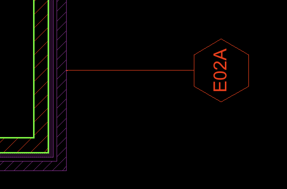

In the end, i want a hexagonal label with text in the center that corresponds to the Wall Type/Composite. Looks like i'll label the plan with drawing elements.

Nooooo! It's easier than that! Use the window label to label your wall. Sounds stupid but the marker gives a lot of flexibility, like hexagon, font sizes, extension line or not, etc.
Label your wall with any dumb label, then set up a window label to look as you would have your wall label look. Then parameter transfer (alt-click, then ctrl-alt-click) the label part of your window label only. Don't worry, it won't place a window there. Delete your window and use that label for everything. Is that suitable? Parameter transfer for labels is a big help, IMO.

I used the "D Marker 10" label as a starting point for my window label. I use the Hexagonal Shape, and remove the dimensions from the label.
After I place the window, i then select the attributes, but the entire window is highlighted - not just the marker.
So transferring attributes from the window to the wall is not working for me. Is there something I am overlooking?

Yeah, label the wall first, before doing anything. It will show whatever dumb label it is set up with by default. Then you alt-click just the label part of the window label (center of the hexagon) you tweaked (no need to delete dims, etc), and then inject this into the dumb wall label, it should turn into your new wall label...

I did label the wall first.
I've attached a PDF showing the Hex shape I want on the window and the default wall label on the right. When I transfer attributes, the only thing that changes is the size and font of the text.
