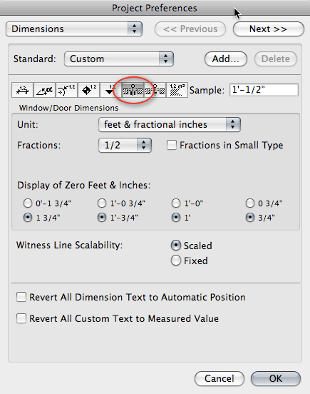

Shae:
If it is the marker dimensions that you are referring to, then check Project Preferences > Dimensions: Window/Door Dimensions. This setting is part of your Master Template, so it should be updated.
David
