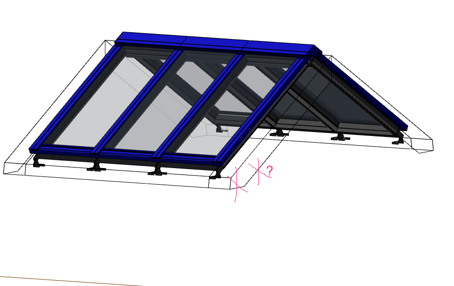

Hi Endre
That was simple and straight forward.
Thank you.
lec
updated:
Please see attachment.
Thank you.
lec
updated:

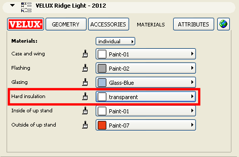

Hi lec,
you can't to turn it off. This is the part of the system.
Not a totally good solution, but if you change the materials to "individual" and give something transparent material to the "Hard insulation" it may good for you for 3D.

That seems to have effectively done it when rendering, but a lot of times I just use 3d capture for clients and that still has the bounding lines of "hard insulation" even when material is set to invisible.
So for me a bit more control over extraneous parts would be helpful.
ie, mounting brackets.
As curb mounting is more common for me.
So an option for that?
