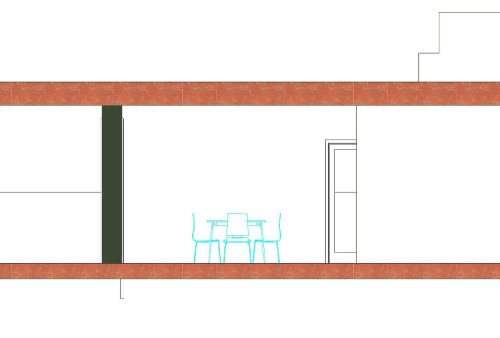

As you can see from the file, the section now is totally "marbled"....
Thanks
Pao

It isn't the surface material of the slab you need to change it is the building material.
Check the building material and I think you will find you are using marble.
If you want a uniform cut material rather than the element's own material then you can go into the 'Filter and Cut Elements in 3D' (CTRL+ALT+A on Windows) and you can set a custom cut surface.

Thanks but the marble that appears in the pic isn't used in this project at all. It appeared after I installed the BIM object, now I have deleted it from the library and it is back to normal, so there was definitely something weird with the BIM Object.

Hi paopao,
is this BIM object related to BIMObject.com objects or BIMObject.com API? If yes which one?
