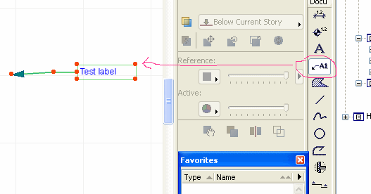

Try going to the label tool, you won't find them in the regular object dialog as far as I know.
Open it, Scroll down to you get to say default door label, and place in on workspace, if it's just a text label you will have to type something in text block for it to stick.
If it's a label attached to say a window, make sure you are selecting the label and not the window.
Select it and choose open object.
Also Archvista has some movies on label/gdl making you might find interesting.
