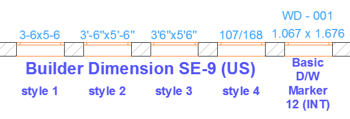

Great that you got it working Mark and doing it by hand always gives a better understanding than just looking at someone else's code.
Having said, that, if you'd mentioned what exactly you wanted from the marker, I'd have probably directed you to the "Builder Dimension" marker that came with the SE-9 library. Have a look at the screenshot.
Style-4 is for use with the metric option and can be very misleading if you stick with inches ! 😉

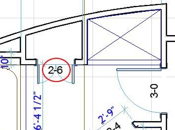

Hi vistasp,
Thanks for your time and help. Here's a picture of what I wanted and why this solution was perfect for me.
Mark
PS I agree, while we may occasionally want majical solutions, there is no substitute for learning a new skill.

vistasp
snapcrackle wrote:
Hi vistasp,
Hey, no problem Mark. That's a neat marker you have there.
